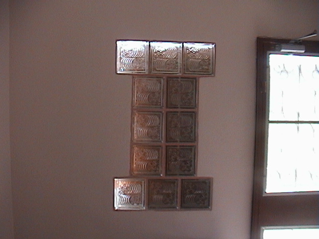

These
glass bricks were poorly placed. This goes
along with the point about spending more time in
the planning phase. When the door is opened,
the glass bricks are covered (which defeats
their purpose of allowing natural light to
filter in. (23-Aug-04) |

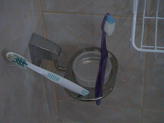

Here
is something you wouldn't (or at least I
wouldn't) think of. A toothbrush holder
where the holes are too small to hold a
toothbrush. (26-Aug-04) |

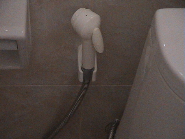

This
is another case where most expensive is not
necessarily best. These Grohe bottom
washers are super heavy duty but somehow
constrict the water flow, meaning that the
emitted water is low pressure. A low cost
standard washer has not problem with pressure.
I know it is these washer since I had two
installed and they both had the same problem.
Later I replace on with a 'cheapy' and that one
works great. |

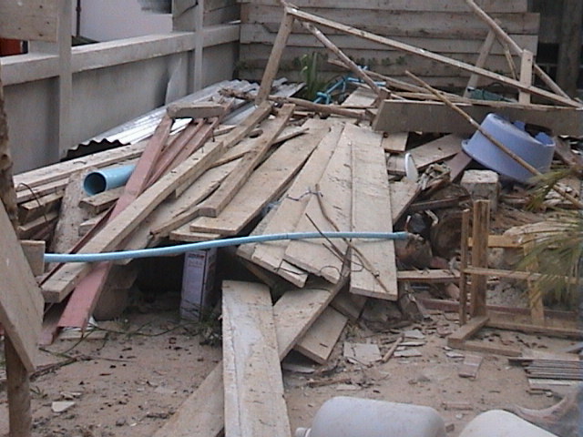

OK, I just thought of another small one.
Grounds control, by which I mean monitoring all
of the liter, building supply fragments, etc.
which end up filling the ground surrounding the
house. Some is unavoidable, but in this
project I waited until the end to get on this
and there was just too much small fragments of
tile, roofing material, etc. all around. |
