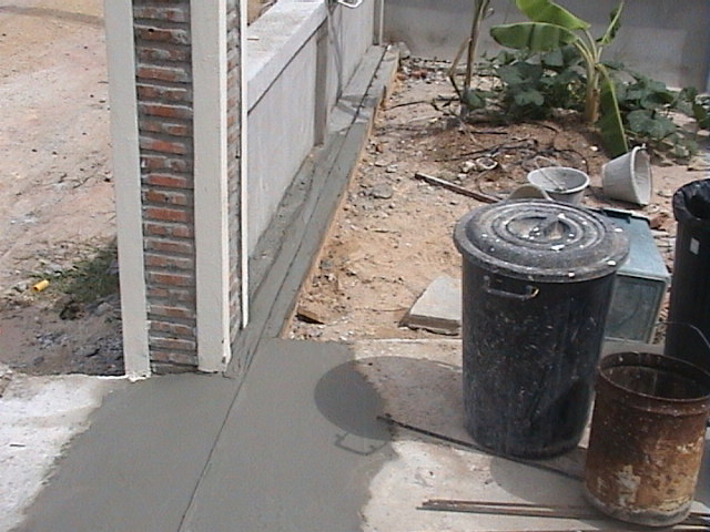

The gate track is laid in position.  (15-Jul-04)

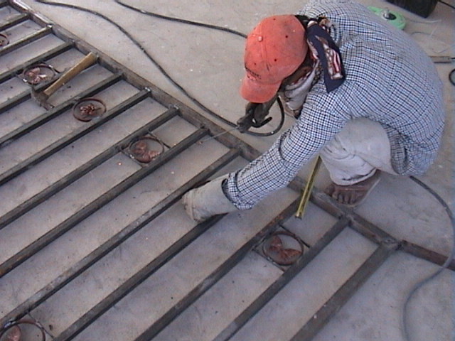

In the gate is composed of 1 1/2 " square metal frame and vertical 1" square metal bars.  The inside circular decorations were bought pre-finished, we use a butterfly and flower design.
Metal being cut at the same time it is welded by another worker.

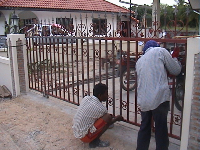

Fitting the gate in place.  The metals are painted with a primer first and then painted with a quality oak shade of paint.  (23-Jul-04)

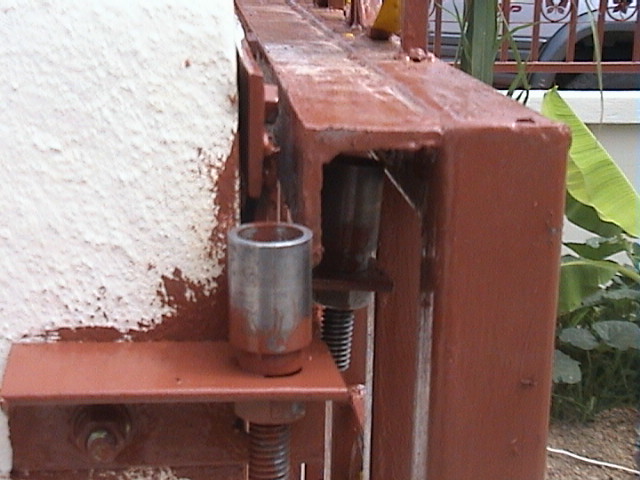

Roller mechanism for the gate.  There is one metal roller on the outside and one on the inside of the upside down 'U' piece of metal.  (29-Jul-04)

The gate anchor.
Another view of the gate anchor.
