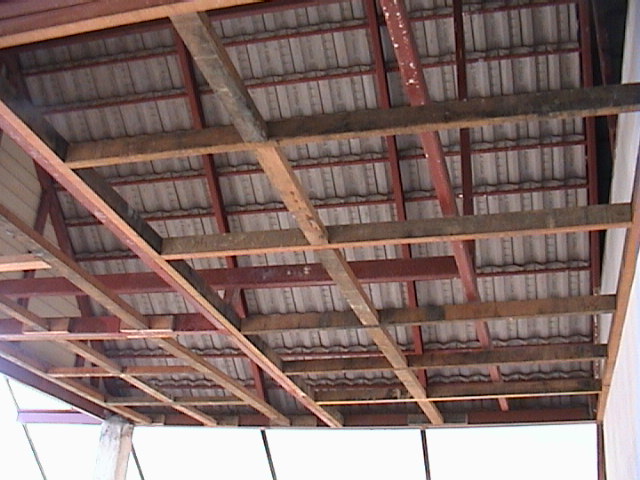

GRC (glass reinforced cement) sheeting is applied to a wood foundation to form the underside of the roof overhang (eves).  The wood is 1 1/2" by 3".  This section covers the grc sheeting throughout the outside of the house, including the carport ceiling.
Building the wood framework.  (24-Apr-04)
Wood framework.  (02-May-04)

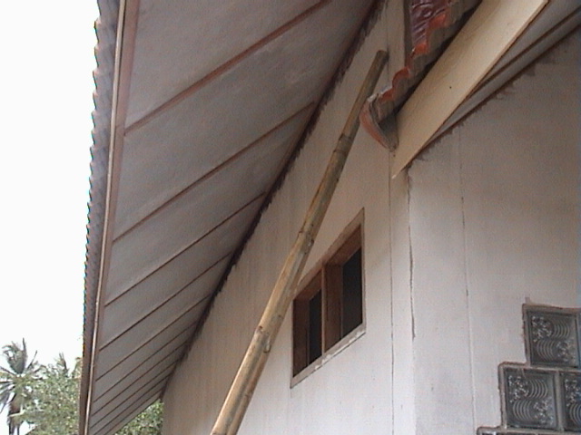

The grc sheeting is applied in sections like this.  Separating the grc sheeting is a decorative wood strip.  (03-May-04)
A partially enclosed section on the back part of the house.
A completed but unpainted section on the back part of the house.  (05-May-04)
