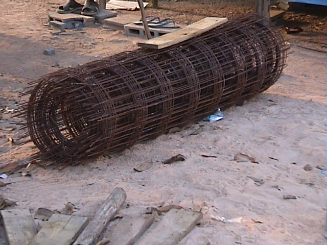

The raw material is called cement, once it is mixed with stones it becomes concrete. The cement section of the basic materials page has information on cement, the purpose of this page is to show a concrete floor pour example. There are a lot of games played when laying concrete floors by corner cutters. The main thing to watch for is the thickness of the actual concrete pour and the metal being used. A friend of mine contracted to have a back patio poured, but couldn't be there to supervise. Later he needed to get at some piping under the patio, so he had to have plumbers come and cut out a section. Then he could see the way the original contractor had done the patio. The pour was a razor thin (about 1 or 2 centimeters) layer of cement on top of sand. The wire mesh was sitting in the sand, which accomplished nothing. Since the cost of materials for flooring are relatively inexpensive it is not productive to try to skimp in this area.
