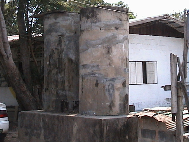

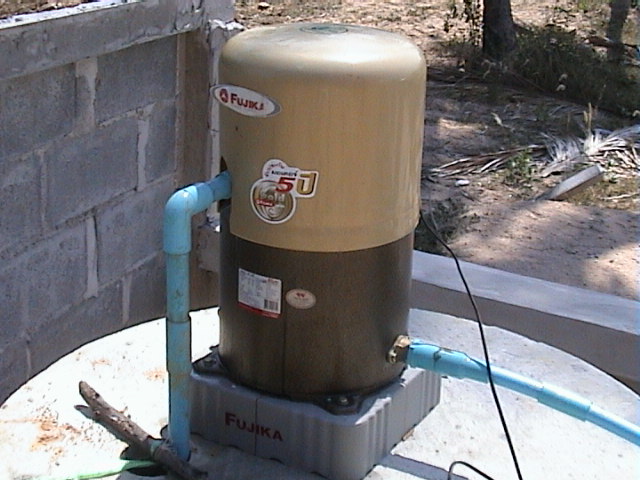

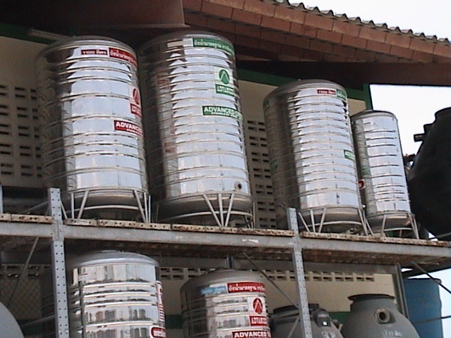

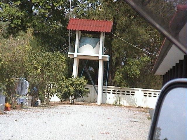

Well Options There are many configurations of equipment you can use to retrieve, store and deliver the well water to your house. At a minimum you will need a pump suitable for the type and depth of well you have. An automatic pump for a hand dug well will cost about 5000 + Baht, for a good one. In my opinion a water tank is also a good idea. First off, it allows the water to be pumped up and stored for periods of heavy water usage (like when the grandkids come to visit!). Secondly it give sediment in the water a chance to settle out. You can either get a pre-fabricated stainless steel tank or have a tank constructed from you. The hand constructed tanks are formed either from concrete well fittings or can be built from cement blocks. The pre-fabricated tanks can be purchased in many sizes, with a 1500 liter size costing about 8000 Baht to 10,000 Baht (depending on the brand and quality of the tank). If your water tank is mounted in a high enough configuration the pressure will be sufficient to drive the water into your house. If however the water pressure is not sufficient you may need to add an additional automatic pump. Often the water tank is mounted in a tower, which will give the necessary height to ensure sufficient water pressure in the house. One of the real nice advantages of a tower is this: even if the power goes out (and the pump is not operable) you will still have water. Also, if necessary, various configurations of filtration systems can be added. Normally there are three filtration canisters used in combination, each one with a specific range of impurities to filter out. water tank and tower
